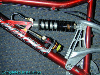

Avalanche 8 inch Bullit UpgradeCraig Seekins
Nov 6, 2001 5:43 PM
One of our customers has upgraded his Bullit to 8 inches of travel.
Check it out here:
8 inch Bullit
Craig
Avalanche Downhill Racing
HOLY SNIKEYS!!!BostonBullit
Nov 6, 2001 6:58 PM
well woulja look at that?!?! I'm digging the entire thing except the drill out the shock mount part. This is very appealing however.
